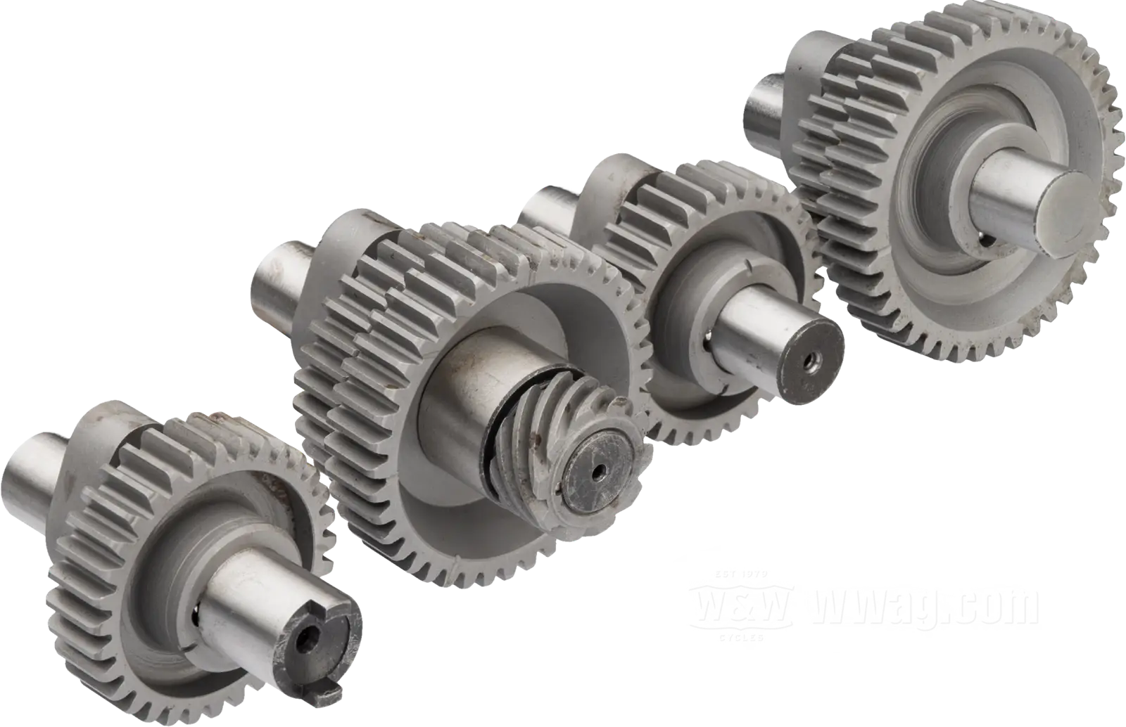

      Engine is where you’ll spend time. It starts here:
      Cannonball Crankcases for Big Twin Flathead 1937-1948. Cast aluminum, replaces HD 24515-37, weight: 13.61 kg.
      You have to buy every single part, one by one, including all hardware. It’s a lot of parts and quite expensive.
      Biggest challenge are connecting rods. The ones for sale with stepped pin are often .010 oversized on the big end. You can remove and replace the races with std size so to use a straight shouldered pin and t and o flywheel.
      cams are also very expensive.
      Equip your Big Twin Flathead (1937-1948) with Samwel cam shafts. Fits U models, OEM replacement. Replaces HD 25512-37.
