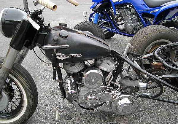

        Alright you guys here are pics of the 67 Sr."V" project before, I will soon have some pictures of during resto to go with these.
          JB, does the starter work? I don't know anything about trikes, but I don't see a kicker? Did the late model trikes not have one?
          Louie
            Rick,JB,
            Well Done! boy youve got your work cut out for you but youll have TONS of FUN!! I personally havent hada servi for going on 20 years when they were no soooo expensive! My last one was bought in Tyler Texas from an elderly lady whos husband had run a service station for years and passed away,we came to terms over the phone, I had never seen the bike other than one picture that a family member showed me at a SHRNERS Convention, Well making a long story short she asked when Id be down to pick it up, Still working as a Firefighterand not having the free time I do now being retired, I responded Ill send a truck in a week or so,here is were it gets good! She says if thats the case dont send your money,after you recieve the MC and like it send the money,I trust you! 10days later the servicar was at my house in Maine,all it needed to run was a plate! and the neat thing about it it had all the tow hitch attachments with it and they were labeled! what a time we had with that machine! After awhile it was sold to a friend in Canada who stills has it. I know this is a little of the topic but thought Id throw it in...After all THE OLD SAGE isnt the only one who has stories!!!
            Will be looking for up dates as you move forward!
            • "jb"
              Good Eye!
              You are correct Louie, no kicker to be seen as it is a 67GE I can add a kick but that would require changing some transmission stuff I would like to make it a kick back up, but thats extra dough not necessary to go around the block. So many other things are needed at this point. Just to bring everyone up to speed, as it sits right now in my garage there I have removed all carriage parts, springs and everything, No Tanks on the Trike as i am stripping them to the metal. No heads on right now Terry has bead blasted them at his shop, Up front is a 74? FX/Superglide Front end with a single disc, 19" chrome spoke which i got 11-13-04 Local swap meet. In the rear are two White letter Dunlop GT 265/50r15's on american racing vintage wheels. I need a Front Truss Bar, New brake lines, Shoes are probally ok for now just to go around the block May need to rebuild master cylinder, I Still haven't purchased a dash and speedo and all electrical wiring needed yet, I need to replace rear chain and the primary chain, I have two incorrect distributors one a 63 xl and one a early style manual retard, I have the M51 linkert about 98% clean still looking for one of those cv's that johnny was talking about. I am currently stripping the tanks, the jugs and a (seat tee) that is on loan it will look new when i return it to it's owner, Oh and one other thing I'm doing not been easy since i don't have a torch yet , replaceing the seat tee bracket some idiot chopped it off. Does anybody want to hear a funny.....? Monday night I got so involed that I lost all track of time went down the garage at 8:00pm thinking that I would just work til 12:30 at the latest.........I was starting to get tired so I went to my cell phone over on the tool table to see what time it was ......3:05 !!!!! AM...!!!! It was 4:00am by the time I got cleaned up and got in bed. The garage now has a battery operated clock. Ha Ha LOL. I'm Lucky to have such a understanding wife. Alright it's time to head to the garage I'll check back later.
