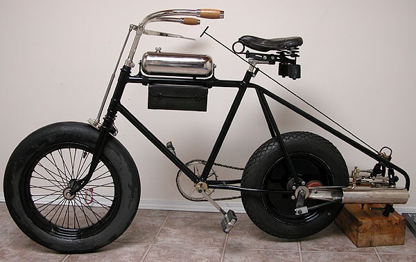

            Here's an updated photo showing the progress. Gotta get back on track here.
            You can see it's been painted and has some gas lines installed etc. Pete?
            I got a chance to talk to Pete and he explained the mingling spark system to me. So roughly -it works like this. The coil is hooked up to a plunger in the bottom or back end of the barrel. As the piston makes contact with the plunger it opens the contact. Ka-boom and so on. The plunger has a spring inside of the combustion chamber. It would get real hot and fail. Modern stainless springs will correct this old problem. Pete can give you more details and info.
            I may have been the first guy to ride the Pennington! I was helping Pete load up because he had wrenched his back and was in an incredible amount of pain. You know that look - when a guys face winces up in pain and he's not saying a damn thing. Just s uckin air through his clenched teeth. Ouch.... He's better now.
            So with Petes permission I hoped on the Pennington (no brakes) and coasted it down the grass hill, maybe a 150 feet. Felt pretty solid. Can't wait for him to fire it up! I kinda got the impression that it may be a jerky, shuddering start with the direct drive - until it gets up to speed. Well..... I guess we'll soon see!

              OK, a better photo from Pete -shows more progress. It's getting close!

                Good grief!
                That thing looks like the images from 1895-96!
                What are you talking about Admin? It's got a brake. Isn't that the rubby thing over the front tire?
                Sure looks like the real thing!
