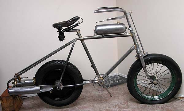

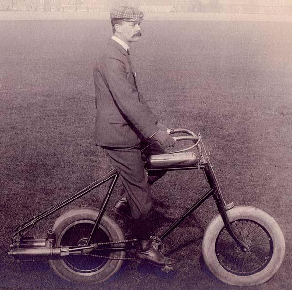

          Here are some shots for everyone from Pete. You saw it here first! Check it out!!!
            Period photo.
              The replica!
