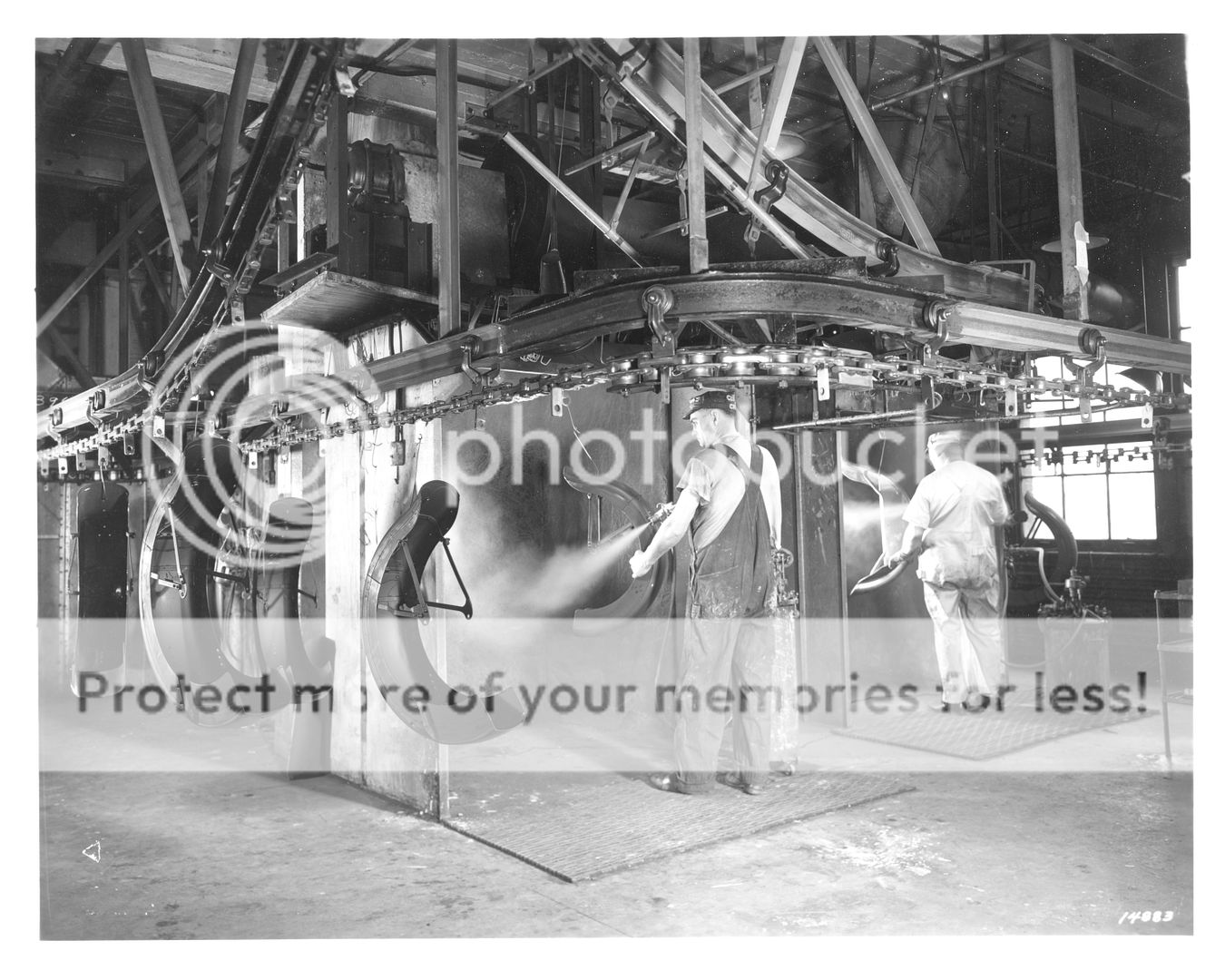

    I have NOS Knuck tanks that are Parkerized in and out then covered with Red Oxide primer. Post war fenders were the same.
    Here are bare metal fenders being sprayed. Paint or primer? With a B&W photo I can't tell.
    Frames were painted with a combination paint/primer. Notice in the 1939 picture the bare metal frames covered with brazing flux being painted.

      Thanks so much for the details Chris. Never knew they parkerized tanks.
      • vph-d
        • Jun 2005
        • 1082
        Tanks and fenders were parkerized, then painted. The red oxide primer over park tanks and fenders were parts department suplied.
