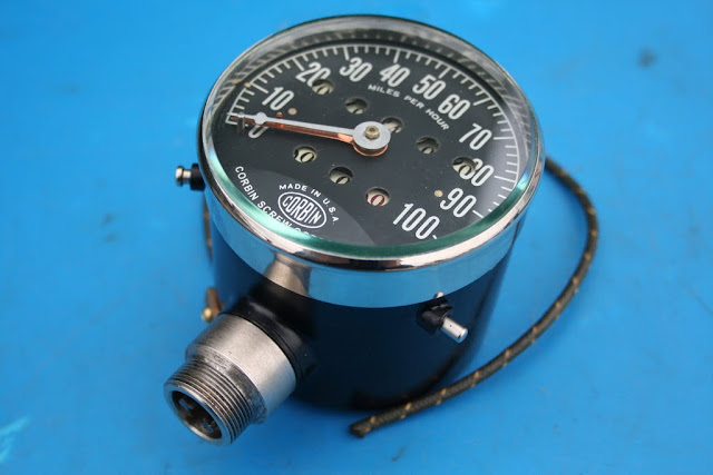

                  Just finish this NICE ORIGNA Corbin

                    Hi Terry...What year or years would the above Corbin lighted speedometer be correct for...Thanks Rod

                      Rod they started making 100 MPH in 1928. Here a picture of a couple of speedometers I am working on.IMG_3487.jpg

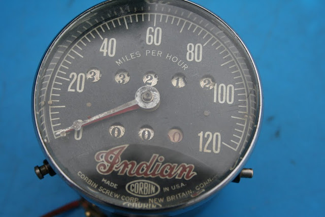

                          The Corbin you have was used from 1910 to 1923. It has a very rare face on it. You could change the face to make it correct for your year. The needle would have to be changed also. That would be the cheaps way to do it.
                          The correct speedometer for a 36 Indian 4 would be 160 Klm or 120 mph with Indian on the face. Maximum speed hand on all 36-37. The should have trip meter.
                          I would look for a correct speedometer.

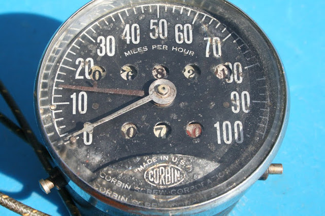

                            So anyone finding any Corbin speedometer's? I would buy any parts you want to sell or trade for working on them. IMG_3281.jpgIMG_3266.jpgIMG_3268.jpgIMG_3269.jpgIMG_3270.jpgI have been busy working on them this winter. So if you need something done, e-mail me at marsh1915hd@msn.com
