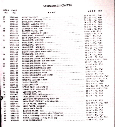

Geez I hate research.
Here is a poor scan of a '65 Parts Book which notes that the stapled bags were issued through "early '64", along with two interesting changes to the spring latches upon the bottom of the bags.
(Maybe I'm reading it wrong, but it also implies that Police issues with radio continued on with the Royalites!)
The lock and key changed for '64, so Kyle is right about a unique '63 latch. It even appears the 'latch plate' behind the '64+ lock was added late in the year.

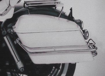

On to 65's,
Here is a partial scan of the '65 Factory production photo, and it clearly shows flat-bottom bags.
Perhaps the 'press mold' bags were introduced mid year? Geez I hope we find proof!
