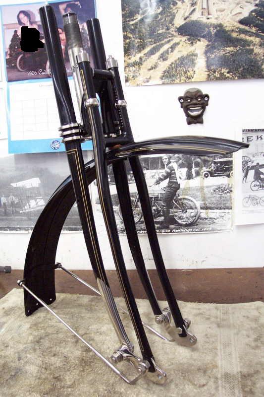

    sager fork attachment
    this is the new fork for 1835,in my opinion the harley sager attachment and the universal sager attachment {the ones advertised in the magazines for all motorcycle use}were the same ,only the attaching bracket was different for the harleys

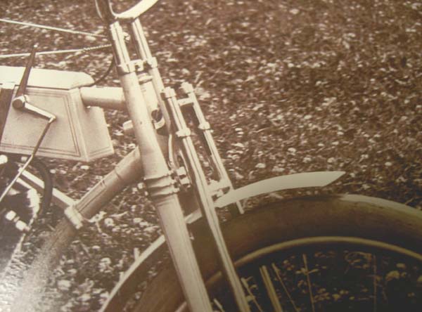

        early sager fork
        I guess I was calling your style of fork the early sager, but different than the ones that attach to the rear legs as opposed to the triple plates. Attached is a photo of Walter's bike in the spring of '07. Note the smooth fender and the attachment goes to the lower triple plate. This also is the same as the #1982 bike. It would be interesting to know the s/n of Walter's!

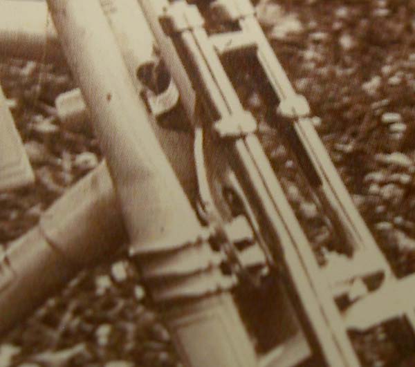

          walters sager fork
          One more photo closeup. I have an 11x14 from the glass negative, so I was able to zoom up pretty well. There are two white spots on a portion of the horseshoe (near side) that I can't figure out what they are... I think it is a problem with the negative or a reflection, but you can clearly see the far side of the horseshoe attachment go to the lower tripleplate. The horseshoe then bends under the lower triple plate and a bolt goes through the three plates to attach the horseshoe on the bottom. While this member is in tension when you hit a bump, it is still a very weak point. It must not have taken too long to figure that out.

                Hi Jurassic,
                Is this new fork, a new restoration, or a new reproduction??
                Nice looking front end, in either case !!!

                  new ,old sager
                  1835's sager fork is a reproduction,as is the whole chassis.unfortunatly the local dealer no longer stocks these parts.

                    That '07-type fork could probably be put on display in a modern art museum and win a prize, although obviously it belongs on a bike.
                    Nice work!

                      Re: early sager fork
                      The most we know is that your photo of Walter in front of the first wooden plant (on Chestnut St.) was taken during or before late July of 1907.
                      We know that because at that time a cropped version of your photo appeared in the "Milwaukee Journal" newspaper. From that we can conclude that the bike is pre-August production.
                      But how early is it?
                      You seem to have a really good copy of this photo taken from the glass plate neg. There seem to be flowers blooming in the photo. Is that correct? If so, that would further narrow down the time frame of this critically important photograph.

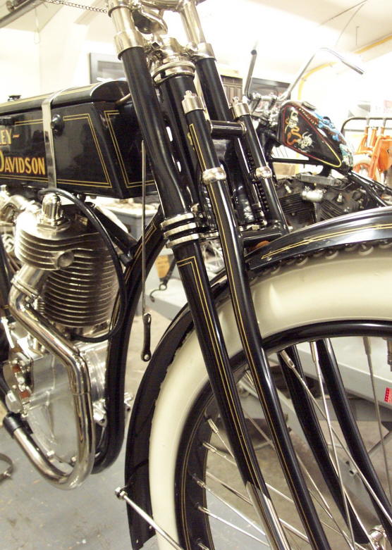

                        1835
                        1835

                          photo - chestnut street
                          The flowers are in bloom in the photo. Spring of 1907 is my guess.

                          Very nice bike, Jurrasic, including the fork! Are you going to bring it to any meets? If not, when you are done, please post some photos here!!
