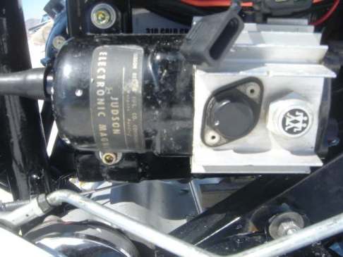

    whats the story with this?
    it appears to be wired like a coil???
    i took this picture out at bonneville and the bike was also at davenport
    but i have no clue which business card corressponds to the bike as I kept missin the guy who built it everytime i was at their booth!!!
    any info would be great!

    Just a guess here. Looks like a coil (fancy wierd looking coil) with a solid state electronic ignition module wrapped around it. Well, the heat sink that is.

      thats what i thought, but is there more to it?
      when did they make them???
      its obviously not a mag, so whats the story

          ive seen a handful of them over the years, all on different bikes...

            A google search on "judson magneto" turned up lots of hits, including this page with details on one for a VW. Also there is one on eBay right now ... Perry

              seems like a hot rod coil if you ask me!

                i believe that's pauls bike from american cycle fab ,the bike was at the saltflat races and at davenport . check his website soon .... got 4 records with it ! contact him for any info or for any flathead work ,great guy
