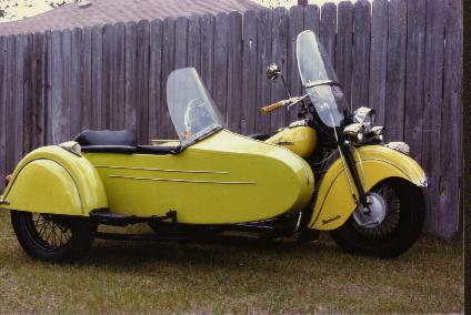

                    • kunzog
                      Sidecars
                      HD Sidecars even look good on an Indian. I had one on a 1948 Chief. Like others, I regret selling it.

                          KUNZOG Shame on you never the bastard child Harley with the PURE BREAD INDIAN!! HA!HA!
