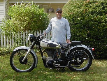

    A Lucas 480 tail-light would have been the stock fitment in 1951. You appear to have a later license plate/stop/tail light holder, maybe a Lucas 564 light.
    A Lucas 477/1 would have been contemporary with the 480 but had a stop light feature included.
    My solution had been to leave the original non- stop light in place and mount a modern stop/tail light elsewhere. There are reproduction early lights like the Lucas MT110 available with a built in two filament bulb to give a stop lamp but they have such a small lens area as to be virtually useless in to-day's traffic. (Modern 6v LED stop/tail lights are made by the Vincent spares company in England to the late 40's Miller "STOP" design and pattern)

      what vintage is the Lucas 564 tailight that I have on there? It looks ok and it works, so I feel safer anyway! Thanks for the insights!
      What are your thoughts on the rear tire? The book calls for a 3.50 x 20 (very expensive) but I can get a 3.25 x 20 easier and a little bit cheaper.

        The Lucas 564 came in on most British makes in 1955. My 1957 Lucas catalog recommends it as a replacement fitting back to the 1953 models. They did not suggest it replace earlier tail-lights because the 1952 and earlier did not have a stop-light circuit or switch.
        I suspect that the dealer may have simply updated the Norton at the time with the approved Lucas update, but added a switch controlled by the rear brake, probably Lucas 22B part # 31383 or maybe the earlier switch Lucas 54C part # 31281 plus the approriate spring.
        The stock headlight would have been a Lucas SSU700P with a pilot light within the reflector for the main headlight. If that has been changed for a non-Lucas (American sealed beam?) headlight there would have had to have been provisin made for a pilot light. Lucas headlight SSU700P/1 has an underslung separate and were fitted to AJS in 1951-53 and Matchless and BSA models in 1952.
        As to tyre size on the rear I do not think even an expert could tell the difference in handling. The larger width would give a slightly taller gearing of a few %.
        I think good, new rubber of a reputable brand is the best way to go. With new, high quality tubes and rim tapes as well.
        Your life will be riding on those tires.
        AFJ
        PS. another Lucas catalog, this one for an unspecified "Export" market indicates that the Norton ohc singles were equipped with a headlight of the SSU700P/1 or SS700P/1 type with the underslung (separate) pilot light. Presumably this was in markets where the local law required a separate parking or side lamp from the headlight. Quite likely your underslung pilot light headlamp is the original as fitted by the factory.

          Yes, I believe the headlight is stock, but the lens is not and it has a sealed beam in it I think...not a lucas. I'm not sure there is a source anywhere to find the correct lens?

            Nice picture.
