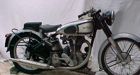

    I am desperately looking for a source for tires for my 1951 Norton International. The wheels (the rear really) is an odd size and I can't find a vintage tire (would like Avon) for it
    Front- 3.00 x 21, Rear 3.50 x 20.

          but I did find 3.25 x 20 here in the states, but will that work when the wheel calls for 3.50?
          • Pete Gagan
            The 3.25X20 will fit fine.

                    I found a place in England (Lambrook) that lists an Avon 350 x 20 on it's website, along with lots of other vintage type avon
                    I e-mailed about the price...I'd like to maintain the correctness of the bike as it is very original and unmolested, and I won't be racing it or driving it too hard (although it does like to go...I only just got it running at the end of the fall and with the old tires did not go far or fast.)
                    Given your choice, what would you choose if you wanted to keep it right and wern't intending to race it?
                    Thanks
                    Joel
                    • Pete Gagan
                      Go for the 3:50, seeing as you found one. Thats a pretty nice bike.

                          thanks for the info-I've located Avons in England for now (but pricey) The rear tire in 1951 for the International was in fact 3.50 x 20 as garnered from my manual and parts book and other sources. The Manx ran the 3.25 I believe, although I am far from an authority
                          Thanks again
                          • AFJ
                            The British Norton catalog and trade listing shows rear as 3.25 x 20 so if yours is a export model and the handbook is an export one it could well have been different originally. As evidenced by the silver instead of black mudguards and the different headlight (external pilot lens?) on your bike.
                            Cataloged rear tire on the 30M was 3.50 x 19 arond that time as the Manx was by that time a quite different bike.
                            • JDC22
                              thanks for the info...I am learning more and more about the bike every day. The mudguards are original equipment, but somebody in the early 60's painted them silver and them hand pinstriped them (and not well)- they arrived here in the states with black fenders/ I have debated painting them black when I have the wheels off for the new rubber, but I like the vintage patina of the tanks both original) and am afriad that the nice new black paint will not blend well with the original tanks, so I might just leave the silver mudders as a "period" modification! I wasn't aware that the headlight (other than the non-lucas lens) was not correct; I do know that the tailight assembly, while vintage is not correct for this model. I beleive that it was changed to accomodate the brake light (also not standard in 1951) which allows it to be registered and inspected here. I bought the bike from an estate and the prior owner purchased it in 1963 (I have the sales invoice) from a local dealer who took it in trade from the original owner. I hope to keep learning more about this rare bike, and as I got it running in the fall I hope to have the tires replaced and registered this Spring. Thanks for your help...all advice is always welcome! I did find the correct tires in England, though the cost is quite high so I might just try the 3.25 instead of the 3.5...we'll see.
