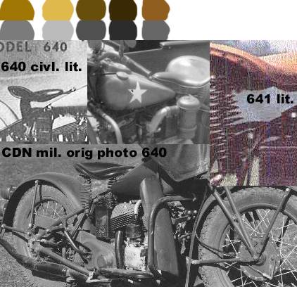

            From this attached picture I hope you can see my confusion. Does the 640 civilian image look black or dark brown? I guess it's dark brown. The earily advert photos were painted over and retouched to enhance print reproduction. Sometimes distorting the image.
            640 "45" Sport Scout
            39 seat was dark brown/tan- cut edge,
            40 "Air-tex" sponge rubber-rolled edge- brown/tan, Mil. cut edge
            41 brown/tan-rolled edge
            American military 640 - cut edge -brown/tan
            Now in the Canadian military photo c.1941 doesn't that seat look black. Bike shown is a 640. gas tank rubbed w/ oil - so a tonal range darker than olive drab, and the seat looks darker than that. What do you think?
