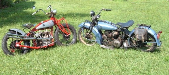

      Here's mine
        Awesome indianut!!!!!!! They look like a hoot!!! I like yours too kunzog! There's some inspiration to get my '41 together.

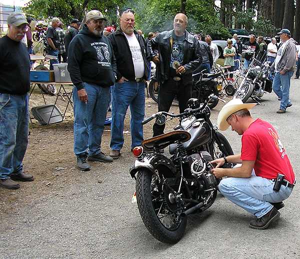

          640 Period modified Bobber. Pretty much stock and correct. *Note horseshoe kicker pedal. I'll make you one if you want.
          Myself putting a hammer head into the distibutor - I think. Hammerhead rotor has longer electrodes- smooths out idle.
          My peanut gallery buddies are offering verbal support. OR... the older fellas, watching the younger fella, to make SURE he knows what he's doing. Hee-hee....
          I was just getting the bike running and it still had some issues.
          L to R - Ian Davidson (Inline 4 Repair). Carl Olson (Carl's Cycle Supply), Tim Lien -aka. Wrong Way Tim, and... someones family member. Big Ed in the bkg w/ the ball cap on.
          • indianut
            Adminguy, how can a hammerhead rotor effect idle? The coil only sparks one time for a split second and as long as some point of the rotor is in line with the cap electrode at ANY point when that spark occurs the plug is going to fire! Also for a SPLIT-SECOND! It's not like the hammerhead rotor extends the duration of the spark or really changes anything right? Or am I missing something here?

                  Degree of rotation -would spark sooner. Hammerhead did smooth out idle for me. That's all I know. Try it, experiment a bit. Apply some modern tricks to your old ignition system. It can only get better!
