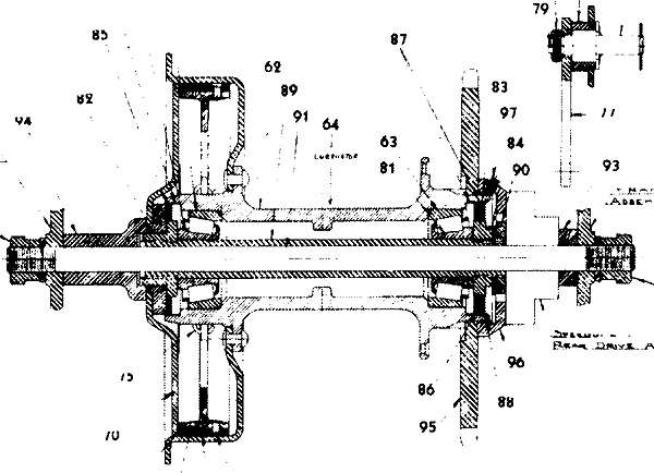

    The Timken replacements on my rear axel (640) appear to be wider. The cup and cone when mated are wider. This makes me think that I may have to plane down the thickness of my axel lock washer and nut by approx 3/16" to get the speedo tabs to engage properly and the speedo to mount flush to the sprocket lock nut.

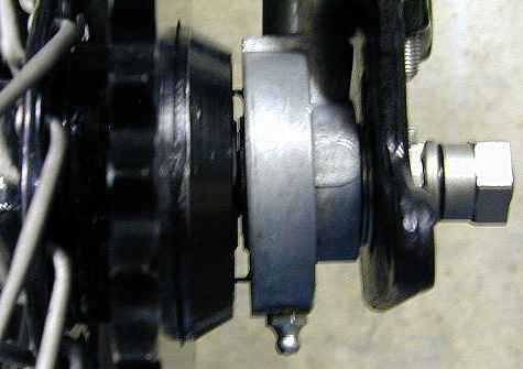

    Here's a photo. Tangs of speedo do insert. I would like the speedo to be flush. Stop road grit from entering speedo. I'm going to take it all apart again tonight.
    Possible nut cut down?
    My sub-frame is factory spec. 10.5" across. Which looks like it may be too tight. As I had to drop one of the spacers also.
      Looks like I'm going to have to cut down the second inner nut. The outer one is heat treated. And so pretty I don't want to mess with it.
      I did have the sprocket on backwards. Cut out on spines faces hub. Hard to see in diagram. Flipping it made little difference.
      Bearing cups are seated.
        So now I hear some guys are short? But I'm long - so I did this.
        I had my inner nut cut it down about an 1/8". (Friends with lathes reap the beer). This did the trick. My lock washer is back in and everything is fine. Lock nut is almost flush with sprocket lock nut (donut). I now have about a 1/16" between speedo and sprocket lock nut. Which I figure is OK compensation for any flexing. I'll gob a whack 'o' grease on the inside of the speedo to protect it from road grit.
        I figure a little space in there is good. Now I'll be able to visually see when my speedo tangs are sheared off, without having to remove axel. "Yup! It's busted. Let's go."
