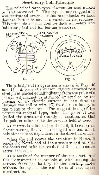

                1935 Dykes Info on Ammeters
                I'm taking Perry's lead and doing some research about this ammeter. I have a copy of the 1935 Dyke's Automobile and Gasoline Engine Encyclopedia. This is an absolutely marvelous source of information on vintage cars, engines and even has a short section on motorcycles. It's over 1200 pages long. The old timers will know of this book.
                There is a nice section on ammeters. There were two types in general use in vehicles. The d'Arsonval movement which was accurate but delicate and used a moving coil. The other type seems to be the one we are referring to which Perry has identified and looks a lot like the US Gauge he pictured. It's known as a fixed coil type ammeter. I have attached a scan from my Dykes of the description of the operation of this type meter. Well, hopefully it's attached.
                To answer Rick's question on how to test the ammeter. I would simply get a battery and a headlight and connect the ammeter in series with the headlight and connect the battery from the ammeter to the other side of the headlight. The needle should deflect one way or the other. If it doesn't there's something wrong with the meter. It appears to me all the current passes through the ammeter coil. If the coil is open you won't even light the headlight. Now if you want to calibrate it then you will have to check it against a modern meter in your light circuit. You probably have a standard Multimeter for checking out wiring. I would guess the headlight would draw a few amps but exactly how much I don't know.
