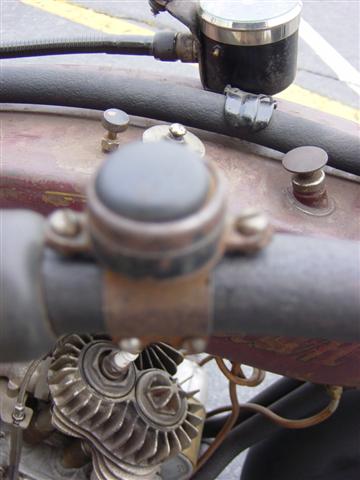

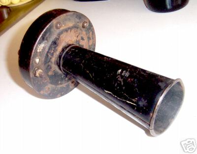

      • Baytown
        1922 Indian Powerplus Horn Button
        And here is the horn, which is the item I need the bracket for.
        If all goes well, Doug may be able to supply the plans for this. I'll keep this thread informed.
        • Baytown
          And the horn button set up
          I need the horn button, as I have the mounting bracket for it.
