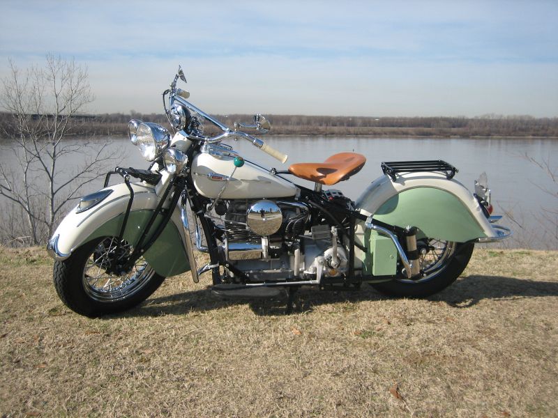

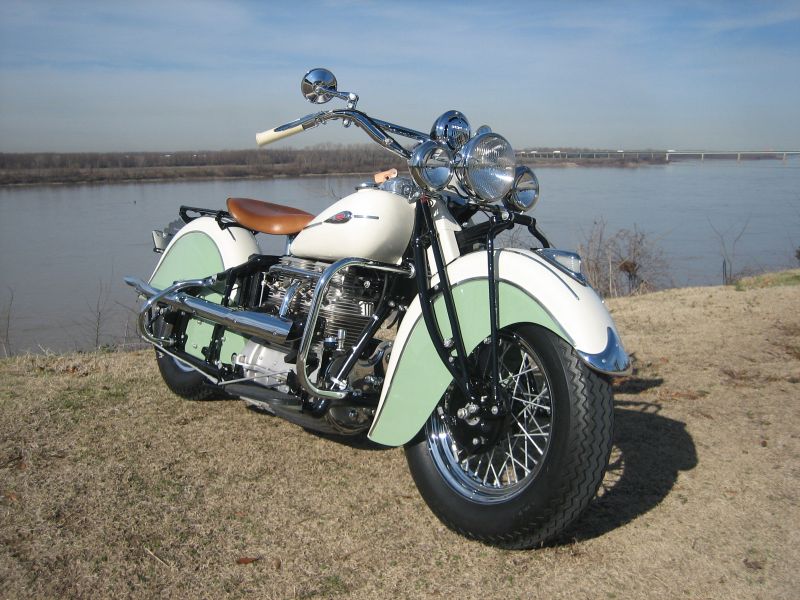

        ..Joe, working on it 10 years, first 4 ride will be on your very own? Man, how sweet it’ll be, that's how I did with my Vincent in the signature below. I was just reminded of my first ride 15 years ago on my then newly acquired 440 just lately having finally gotten this 441 on the road again after much determined effort.
        There’s nothing more exhilarating than a crisp winter day to fire up a machine that’s not turned a wheel in over half a century under its own power. Made all the better by completing a 13 year restoration saga (10 of which spent learning a valuable life’s lesson or two about sending one’s motor off to the hinterlands) when you’ve done everything yourself in your garage except the plating and machining.
        All is forgotten now, looking at these scarred-up gnarly nubs for fingers and recollections of hundreds of hours spent in clouds of dust, sparks and paint fumes. Though I’ve ridden my other one for 15 years, the sweat, worrying and improvements made setting off on this one like riding a 4 for the first time all over again – and I was reminded, you’ll be blown away – and there’s nothing quite like these machines despite their foibles.
        First pic is of the day I collected it from the seller, the last of his dozen 4’s and last old motorcycle. To diminish the pain, he departed in the opposite direction in his Model A as I trailered off his machine he’d had since the 50’s, in 1995, still on it’s 1958 open dealer title from his m/c shop. JWW, as Calvin will attest, your chrome chap’s work is simply over the top. Those are the original rims, which naturally, I had to lace with perfect original single butted .175’s and .343 nipples cad’d up nicely. The Crocker steering damper looks like jewelry, I’ll never use anyone else.
        Regarding Robbins/Egge’s, it’s not that they are inherently flawed - have run them for 10 years in my 440 - it’s just that piston/ring technology has made huge advances and CNC equipment enables small/individual runs in intermediate sizes at reasonable prices. Where you can run into problems with these pistons are hot weather/high speed riding with lean fuel mixtures/incorrect ignition settings – primarily from intake manifold leaks on 38-42’s – wherein these thick 4 ring pistons using tension technology, rather than gas expansion - have you closer to the thermal limit. Throw in one of those variables and you may either lightly soft seize at the skirts or wear your bores prematurely. It is not uncommon to shut a motor off so equipped in hot weather and then have it very difficult to kick through with the ignition off till the pistons cool/contract. Good luck with yours. [B]

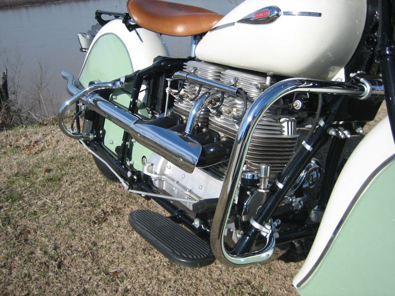

          pic 2

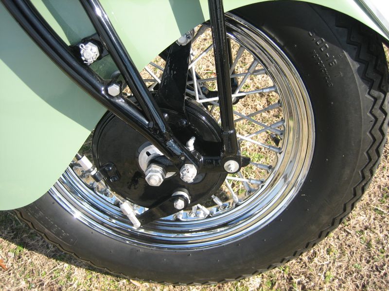

            pic 3

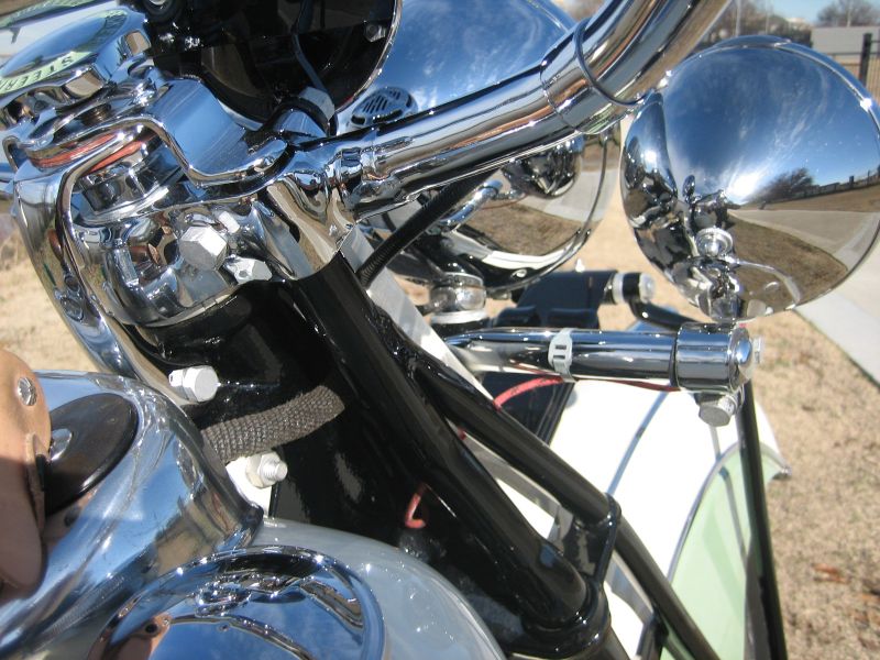

              pic 4

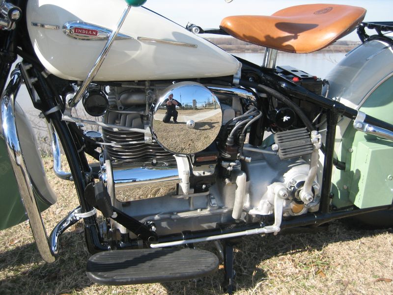

                pic 5

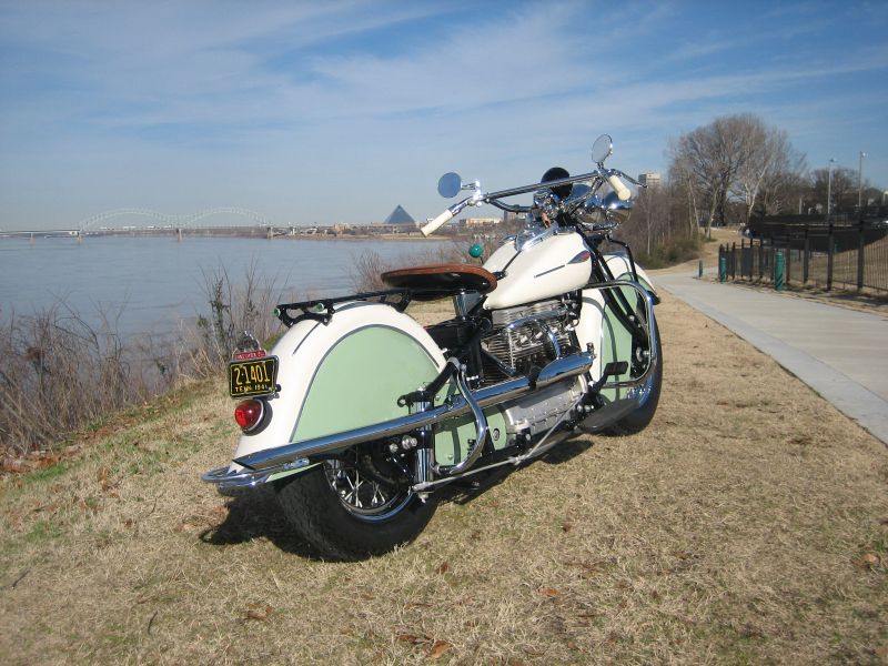

                  pic 6
