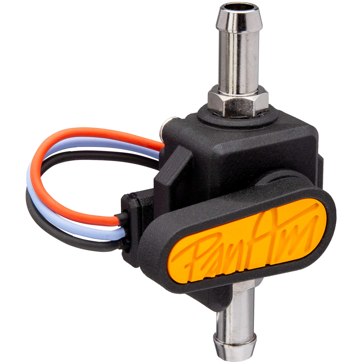

                There is at least one or possibly two manufacturers of shut off valves made. I know the one came in two different versions. One was strictly a mechanical shut off. But it was also available with a electrical switch built into it. The bike couldn’t start until you turned on the oil feed. I think it is a British made item. But I think there’s another one made by someone else. I saved the information for the British one but would have to search for it.
                I did some research a company called Pan Am Oils has one with an electrical cutout built into it. Out of stock now but handled by
                Low Brow Custom. I know the other one was British and sold by a British motorcycle parts supplier.

                        Pre-TwinCam engines have a spring loaded ball check valve to prevent the engine oil from seeping down to the crankcase. These check valves don’t last forever. If you try to start your engine after a lengthy period of inactivity (e.g. winter), the oil in the crank case gets forcefully ejected via the breather. Creating an ungodly mess on your garage floor. Installing a manually operated valve in the oil feed line from tank to oil pump can prevent this, but carries the risk of forgetting to open it. Resulting in major engine trouble. And we mean major. This here nifty PanAm shut off valve is also installed in the feed line. With a little difference: once closed, the ignition is cut out too. No inadvertently starting the engine with this baby. The tough polyamide housing has several mounting holes which offer all sorts of possibilities to secure it to the frame or other convenient hard points. fits models Pre-1999 for 3/8” ID hoses polyamide / brass / stainless steel, black / yellow, chrome-plated W x H x D: 31 x 42 x 45 mm with 30 cm long wires

                              I am still on the 6-Volt setup. I am wondering if the Pan Am Oil shutoff will work. It seems like it would - it just looks like it shorts the system until the petcock is switched over.
