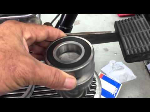

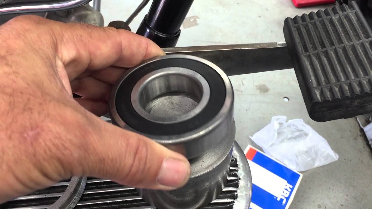

    ...at around 35 minutes into this well done Kiwi video, Mike Tomas presents an argument for sharing oil between primary and gearbox...FWIW!
