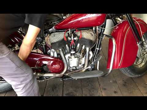

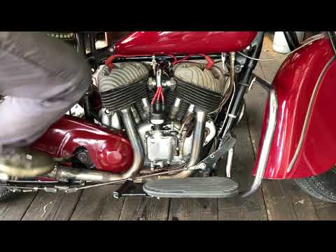

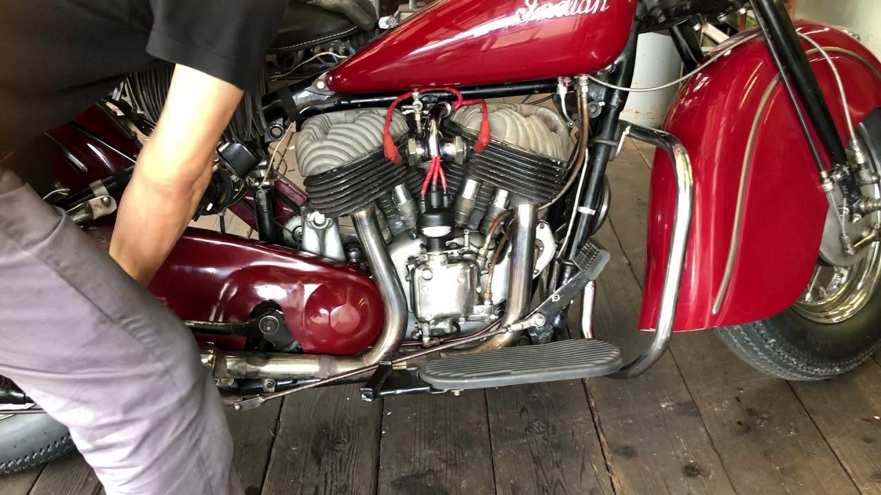

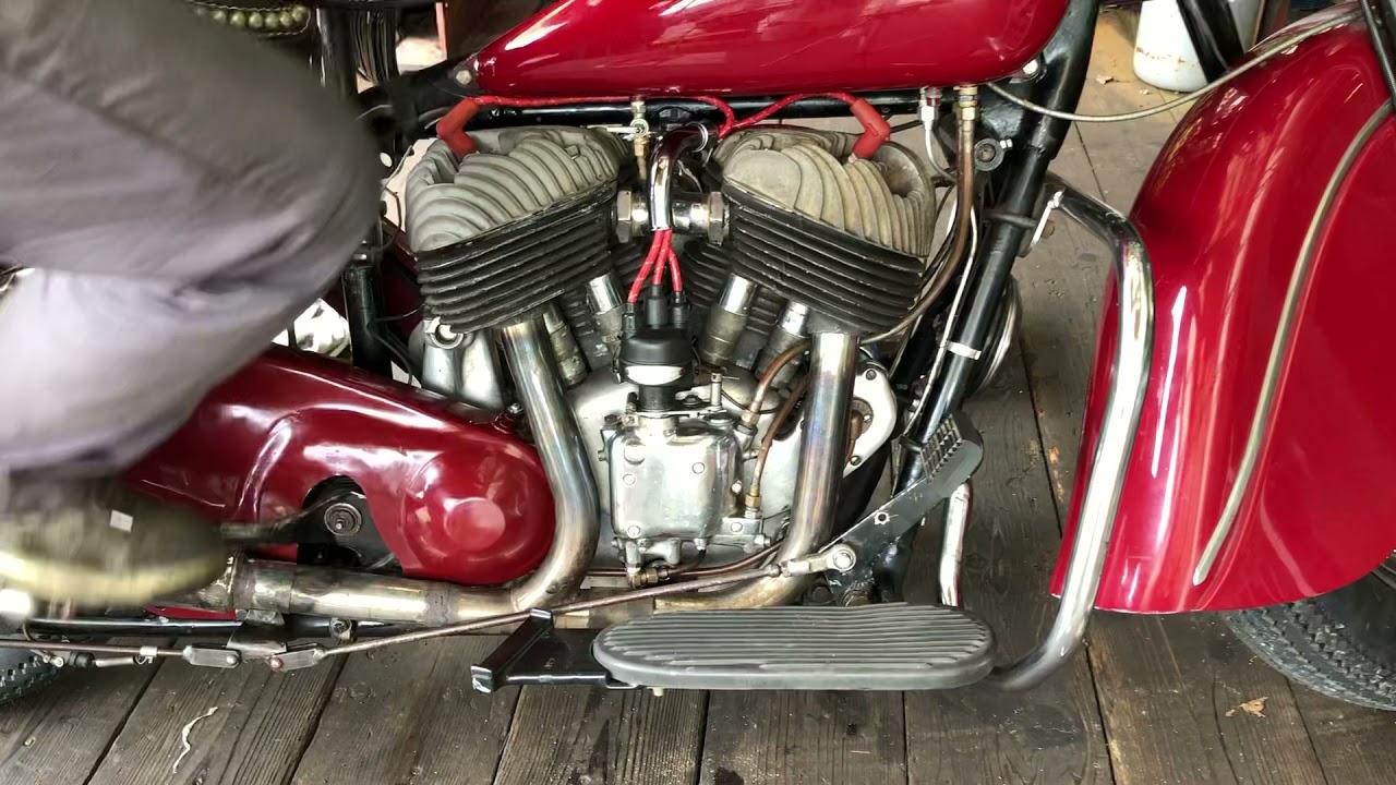

    Hi experts,
    she was running ok today but suddenly start to whistleing like this...
    any advice where its from..??
    tks!!
    Shin

    Sounds like you have an air leak somewhere... maybe a head gasket. I also have found a leaking sparkplug at the threads or where the insert threads leak at the aluminum head.
    Many years ago, on my '47 Chief I found the front head had a crack (undetectible, until the head heated up). This one had the crack right in the middle of the combustion chamber, about a half inch long. I found that one by putting some gun bluing in the sparkplug hole before I started the engine. After a few minutes the crack showed up across the outside of the top of the head, between two fins. Usually a crack at the sparkplug hole is pretty easy to see (not always).
    If you dont want to tear apart both heads... open the valve covers, rotate the engine watching the valves as both are closed on each cylinder, respectively. You will be looking for which cylinder is on the compression stroke. It may help isolate which cylinder is leaking. Sounds like a pretty big leak... so, hopefully it will be fairly easy to find it... Good Luck. C2K

        Howdy sir,
        Very melodic there. The tone doesn’t seem to change on draw or compression and is present for both cylinders, I’d pull your breather off and check to make sure the disc and gasket are in place. That sound is reminiscent of the Krank Vent once marketed for Chiefs which partially sealed off returning air to the sump on the compression stroke. Most of us concluded fitting valve stem seals and good gaskets were more elegant solution.

              thank you guys for the useful advices!! on the first video, I took off the spark plugs so no compression on top. so... it comes somewhere from crank case.. so,,,, must be breather.. .. will check! tks!! Shin
