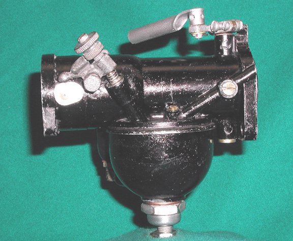

        Die-cast potmetal Scheblers (bare until mid-'35?) sported a thin gloss black as shown in this concerved original-paint DLX110 (attached).
        It appears that even the cad bowl lid was painted.

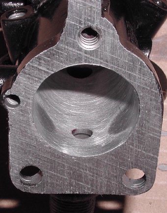

                Warning: potmetal is technically a liquid. At higher temperatures it can become fluid, as a pass of the hone through this Four carb demonstrates: (attached)
                220F seems safe.
                • KNUCK
                  I see the result of this over cooked carb. I will bake to the proper temperature.
                  Thank you Emril, I mean Cotten.

                    NO! Pot metal is not a liquid at room temperatures. Most "pot metal" items are zinc alloy die castings which start to melt around 600F or so. In the jpeg, I see no evidence of melting--just some low spots in the bore that did not clean up with the hone. I have a degree in Metallurgical Engineering and have worked in the casting industry and know these thing

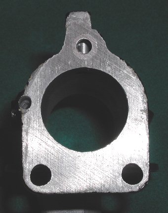

                      More distortion attached. Note that the hole is not anything like round. Instead it looks like the carb was made of wax and left in the sun.
                      Thirty to forty thou out of round has been found on '38-'39 Four carbs, the worst for heat distortion.
                      It is such a prevalent problem for these models, that the value of a serviceable core has exceeded a more common model by tenfold.
                      With all due respect, Swall, your degree only taught you to see the short term of things. We are dealing with the cumulative effects of seven or more decades. And that's a blink of the eye, nay,... a nanofart in the dark,.. when compared to a geological process. However the molecules in our machines follow the those same rules of Nature. Dontcha just hate that crystal cleavage signature when a part suffers a catastrophic break!

                        T.Cotton--I had another thought on this. As zinc alloys melt around 600F or so (I will look this up when I get back to work) the alloys will tend to warp at much lower temperatures. So, warpage could occur at the higher end of paint baking temperatures, say 400F. So, if warpage occurred in the bore, it would result in the non clean-up when honed, as your pictures show. Zinc die casting alloys, such as Zamak, contain around 4% aluminum and some other metals, depending on the specific alloy.

                          It is not unusual to find airhorn screw holes have moved, with the mouth of the carb appearing obviously oval. Manifold flanges are often dished to the naked eye. Bores are often constricted to where they must be honed so that even an original throttledisc can be installed, much less an oversized one.

                            Cotten--the distortion you have described is classic "creep" phenomenon of metals. Creep is metal movement at elevated temperatures due to stresses, either applied or residual. Castings contain residual stresses (locked in stresses) when they are cast and sometimes the casting will distort when machined. Other times it will not, but will eventually distort after long time exposure to elevated temperature. This long term distortation would be due to the original locked in casting stresses as well the applied stresses (stuff bolted on, spring loaded assemblies as you have noted, etc). So, where am I going with all of this scientific nonsense? Back to the original question--what is a safe paint baking temperature? The answer will vary depending upon whether the carb body is a zinc alloy casting or aluminum alloy casting. You have stated that the scheblers have varied. I would guess that prewar stuff tended to be zinc and post war stuff tended to be aluminum. Aluminum would not be a problem even with with a 400F paint bake. Zinc would be problematic at a much lower temp. It may be that it starts to move at tempertures lower than the max service temperature! In that case, the paint bake temperature will not matter, as long as it is lower than the operating temperature. Probably around the 220F figure you cited. As to your welding observations--there may be a simple chemical spot test that would alloy a zinc casting to be distinguished from an aluminum casting. I will look in to this if it would be of help.
