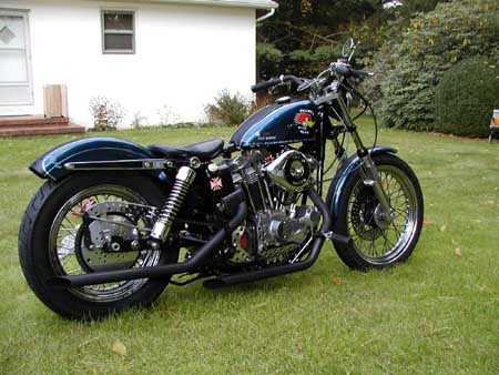

    Well, finally a pic of my Iron Head Sportster 'Drag Bike' project I've been working on. Right now its set up to run legally on the street, (barely...w/ temporary forward foot pegs, lights, small mirror and a horn that goes Beep!.. Ha!) There's no generator, so it runs 'Total Loss' electrics, (waiting on the Joe Hunt Magneto) Been twisting the throttle at the stop lights and one or two sections of Rt23 and Rt80 while I make adjustments. Still a lot of work to go!! Been busy working on the rear aluminum struts and fender supports as well as the rear shifter/brake sets. Putting the NOS Aluminum wheels and hubs together at this time also. Will get started on the Fiberglass 'false' fuel tank shell and rear fender soon. Lot's to do!! Remember I'm keeping it to 'Period' Parts and HP Mods only, so there's more researching and parts scouting yet to do also. No hurry....as I want it to be correct to show at AMCA and hopefully a dependable/consistant Racer! Check the 'Parts Wanted' site for some of the things I still need....It changes as I find the parts and add/change others. Thanks L.A for re-sizing the photo for me!! Someday I'll fiqure out how to get it done myself...don't hold your breath though...cause I have a small brain and thick skull!! Takes some time for these new fangled electronic stuff to sink in!! Ha!...Later.. ..Hrdly-Dangrs........NOW LET'S TALK SPORTSTERS......

    That is sharp..!!!! to put it mildly. It must be a blast to ride. I hope you bring it to Harmony this year so we can check it out in person. RIDE ON

      Thanks Doug. It's been a fun project to date. I have a spot at Harmony and will be bringing the Sporty with me. Does make for a great Street bike and 'Bar Hopper'. But it's destined to be a legit Drag Bike....Should have the 18" R and 19" F NOS Aluminum wheels on it by then as well as the Aluminum rear struts and rear sets. I don't know, theres something about these old Ironhead Sportsters....Maybe the sound and vibrations....whatever....All I know is whenever I jump on this bike and run it thru the gears I feel 17 years old again!...... .....Hrdly-Dangrs
