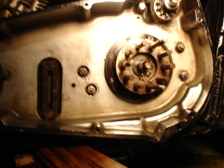

    I have a 68 flh and am trying to figure something out. The service manual states that the priamry chain is oiled and "excess oil collects as the rear of the chaim compartment and is drawn back into engine gearcase breather".
    So just where is it drawn back?
    I noticed the cover had a drainplug as the rear. When I removed the cover, an excessive amount of oil drained out. I'm assuming it was due to the fact that the bike sat for 7 years.
    Any insight would be appreciated.
    Thanks.

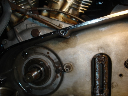

    Here is another picture...
      And one last picture...

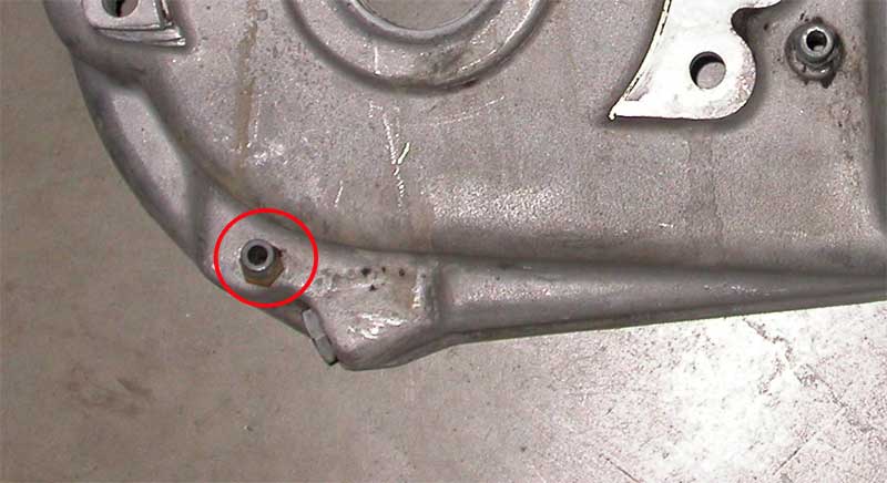

        Is that a genuine inner primary? There should be a return nipple near the drain plug (see attached photo showing the backside of a stock primary). Check your manual but I think the return is hooked up to a nipple on the crankcase that feeds into the breather. 68 is the first year for the new oil pump and I'm not sure if that changed it ... Perry
          Thanks Perry
          That solved the mystery.
          The inner is original and has the nipple on the back side that connects to the oil pump. The "reserves" I found in the primary must have been from sitting.
