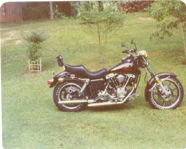

                          Here is an old pic of my 79 FXS. 80 ci Low Rider. I bought it used in late 1980 for $4000. This thing vibrated so bad that I couldn't read the speedo or tach past 60 mph. I could rev the motor to 3000 rpm and it would "walk" around on the kickstand.
                          I knew these bikes vibrated a lot but this was way out of hand. Finally I ask an old harley mechanic at Colbach HD in Morristown TN. about it. He agreed that this was a "little excesive". Told me to check the upper motor mount. Claimed they were always breaking on this model. Guess what? It was broken . I replaced it and this old Shovel was smooooooth.
                          FYI. This pic shows a correct 79 80ci fxs except for the exhaust and air cleaner.
