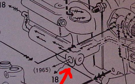

      I found out why I didn't have pressre into the primary... The internal passage, where it takes a 90 degree turn, just behind the oil pump, opened up like a '65. now I have 2 problems, how do I plug that so my chain gets oil again???
        The hole I'm refering to is the 1965 breather vent,(a pic is worth a thousand words, see below I don't know what came out of it to allow the breather to vent there, but I can't oil my chain til I plug it again... any ideas??
          I think that hole uses a pan shaped plug. I don't think automotive freeze plugs come that small, but you could stop at NAPA and check what they have. VW uses some similar type plugs in their oil galleys in the cases.
            I lucked out, upon further investigation, my hole is tapped for 1/4 inch IPS, just screwed a plug in it!! The old one must have worked its way out...
