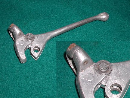

        I was shocked to look in my '65 edition of the Parts Book to find the same drawing as the common -68 reprints, as I have two lever assemblies with no hole for a mirror.
        Then I flipped a lever assembly over and figured out what the little circle in the drawing apparently represents (see attachment.)
        The '65 book lists no lever assembly for the clutch booster at all!
        It only lists the new ball-end levers for the brake.
        I run my brake on the right-hand side, so the dimple escaped my notice.

          Hey T - that's exactly what I would have expected to see! Thanks for clarifying this. Looks like one of the previous owners drilled mine out. Probably pretty simple to just center punch in the middle of that little circle! Actually this fits when you relate it to the castings they used for the primary and timing covers. Stamping inside the cases say -65 but the same cases were used for 3 years or so and simply drilled out (or not drilled out) differently to meet the newer design requirements.
