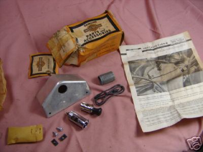

                  • Lonnie
                    Flthead is correct - if you tried to mount a cig lighter in the hole placed in the handlebar cover for the steering damper you will prpbably find that there is not enough clearance for the wiring without hitting the fork stem. The cig lighter goes in a separate piece that mounts on the front of the h'bar cover with two screws that go into the cover. This piece is triangular in shape with the longest side being designed to fit smoothly against the front side of the h'bar cover, the screw holes are in each top corner. Perhaps someone has one and can attach a photo.

                      • Perry Ruiter
                        Originally posted by Lonnie
                        ... Perhaps someone has one and can attach a photo.
                        Lonnie
                        Part number 91800-60 ... Perry
                        • Perry Ruiter
                          Close up of the instruction sheet ... Perry
                          • portagepan
                            Perry, are both ends of the wire closed loops? I have the black wire for mine, but the hot lead to the cigarette lighter I have is too short in the outer casing for a loop to clear the metal. There is a screw on wire end on the lighter that came with it when I got it. The plunger of the lighter says 72 Casco 12V. I suppose any lighter will work, but I am just trying to get original.
                            Thanks, Mike
                            • portagepan
                              Have to reply to myself here. I was looking at the wrong lighter here. The one I was looking at was in the handlebar clamp cover, not the add on piece in your pictures. I went and found that one, and it is just like yours, and the wire with a loop end on it will work fine. One thing I can't see in your picture, which I suppose you have, is the grommet, that goes under the rolled edge of the lighter case to insulate it from the aluminum bracket. Mine was rotted, so I just put a rubber o ring there.
