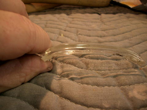

    Greetings from the Arizona desert! Anyone left up there in the mid- and north-west? I've been dodging those RVs from up there all month! neener, neener....they haven't hit me yet! I just got a NOS outlook (license plate light) glass lens for my '63 Duoglide. For some reason it came out of the unopened box with a orange tint all over it. It doesn't appear like it is from the print on the original Harley box. Is it supposed to be that way? I'm all alone down here with only 3 vintage bikes in all of Yuma. How about you big town guys helping me out. If you don't hear from me again, some Winnabago got me driven by a 100 year old couple from Michigan or Washington!!!

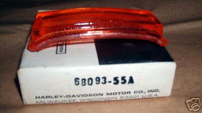

    • Perry Ruiter
      It can't be as bad as this one can it? ... Perry

        • Perry Ruiter
          55-72 if you look in a late enough book. My 68 parts book still lists -55 so the -55A part must have come into use after that. As for why, I guess you'll have to ask Harley that ... Perry

              • Robert Luland
                The one book I looked in goes up to 68 and its still 55. Perry did you shine a red light though that lens?
                • VPH-D
                  Have you looked real close at the lens? I seem to remember seeing those lenses covered with a reddish plastic film.
                  VPH-D
                    I also have seen these that are covered with a almost vaccumed sealed red plastic and the A would reffer to later than 55 as an upgrade i do believe

                          • Perry Ruiter
                            Inline is right, in the post 51 numbering scheme a letter after the part number usually denotes a revision in the part (every rule has its exceptions of course, like the P parts for the Italian bikes, R for racing and Eagle Iron parts ending with T (presumably meaning Taiwan), etc.). I have no idea if the lense in the photo has a film or not. I don't own the part ... Perry
                            • azpaul50
                              Yes! Like that!
                              My lens is like the pictured red one except that the tint is less dark and uniform. It is a little splotchy when the one in the pic is uniform. My first impulse was to wash it off with water. That doesn't work. I'm sure it comes off with solvent but I'm not sure that I want to do that if the red is "they way they come." Of course, the tint doesn't do beans to illuminate your license plate. So, if you were trying to stay "correct" would you take the tint off or not?
