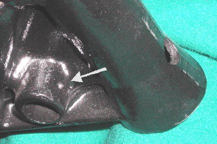

        I'll try to attach a photo of a stripped headstock that shows the where the pin was drilled out.
        It is at about 1 o'clock as you look straight at the core, and usually you can feel the nub of whats left after the original pin was chisled off.
        The drillbit must lay nearly against the headstock, so the front fork must be removed. As I posted before, the critical aspect is to only drill out the pin, and not into the lock core! I use an old key to hold and wiggle the core, and eventually pull it out.
        Note also that the plunger must be removed for cleaning as well, and you will see where the welch plug on the very front of the headstock has been removed for access.
        Grease everything for reassembly, and I religiously omit the spring.

              As I posted before, "I tap the hole for a setscrew for future repairs, and hide it with thick paint."
              The original may well have been a self tapping screw that is sheared off intentionally with over-torque. ('Xcept those late Pans with rollpins.)
