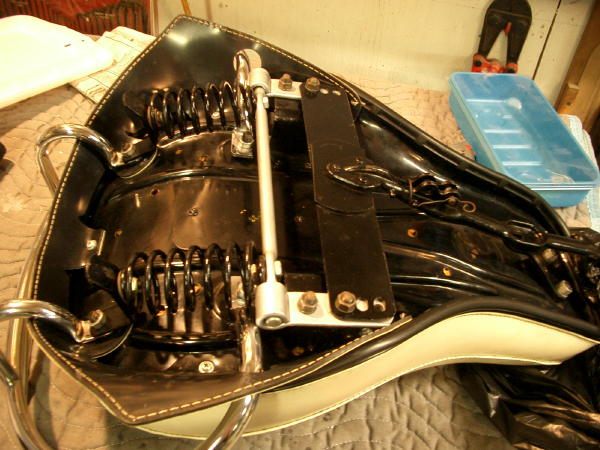

    I looking for a picture of the big buddy seat deluxe, on how it attaches with the springs . I just picked one up with the springs, retaining rod. I know I'm missing some parts but it seems that after mounting the springs with the brackets they come close to the outside of the seat, and I was thinking that they shoulds be more towards the back and close to the center
    654Eglide!
    Sorry for the late reply, and the cobwebs in the attached photo;
    Does your hardware look like this?
    Note: button headed screw assemblies at base of springs should be Cad; overspray mea culpa yesterdecade, or longer.

      no, but thats what I need, thanks

          These are the same, except the 65 only shoulder bolts are notched, and take the clips to hold them on the frame when in use.

                  thanks for the offer, but I got all the stuff at a local shop the guy had lying around. problem I'm having now is that I don't seem to be able to get the springs down into the notches in the frame brackets. seems like there really hard to get in there. is there some trick to this? if I remove the pin for the seat post it works fine, but then I can't push the seat down far enough to secure the pin back into the t-bar
