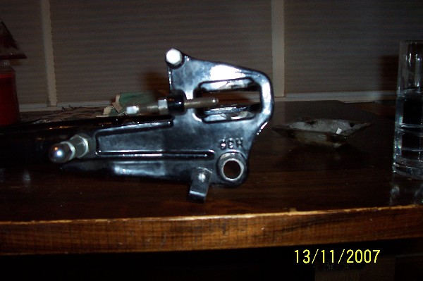

                  There are early and late round swingarms. The early ones have casting numbers on the outside of the axle clips on both sides. the late ones , 63 and up I believe, have 2 reinforcement ribs on the outside of the left clip and the number is on the inside. I think they were feinforced to support the new bigger brake.

                    • koanes
                      There is a 58A and 58B version of the 63 and later swingarm, although I haven't spotted a difference between the A and B. Maybe grease fitting related?
                      • bmh
                        I know the real early ones did not have a zerk, I think they added the zerk some where 60-62. All I have are late modle ones here I think, but I'll go rooting around and see. I can at least post a photo or two of the 63 and up variety.Try to do that for ya by the end of the week.

                        • bmh
                          ok. I need some help. Got some photos to post, but whatever I try I get a message telling me file is to large. What don't I know? Will post them as soon as I find out how.
                          Brian
                          • portagepan
                            If you are attaching it from a stored photo program, just go to image, and resize it to around 600, for your first dimension. It will auto size the other one. That will upload easily.
                            Mike
                            • bmh
                              Thanks, here is outside of late modle left axle clip
