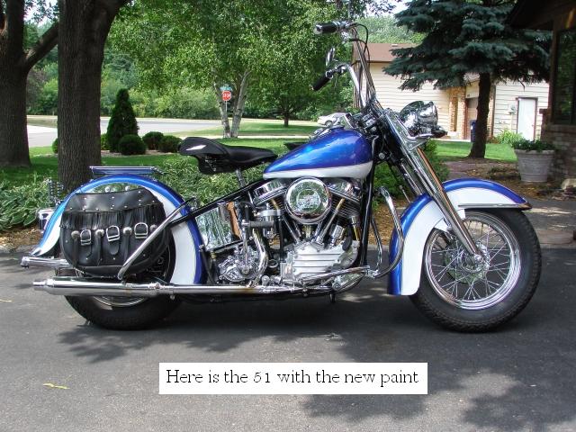

              Mines' not stock, seems I like chrome....but I did restore some of the original features, like the seat post,fork lock ,steering dampener,oil filter as well as rebuilt from the ground up to new bike. Mike
                Very nice looking ride and yes your chrome fetish is showing. But I have seen photos from 1951 enthusiast's that show brand new bikes with almost as much chrome. I do see a lot of updated parts, looks like it should be a good rider as well as alooker . thanks again , Brian
