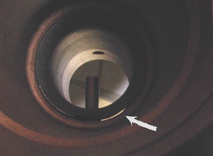

                Well, like I said, this is a m-74 B, off of my 1965 FLH. Part # 38 in the parts book, for Harleys, '58 to '68. The carb I had on my bike which worked good, has a main nozzle with 5 holes on one side, in a vertical row. The square alignment shoulder is a solid square. The main nozzle on the rebuilt extra carb I have, is a little taller, and has 5 holes on one side, 5 holes on the opposite side, and one more hole just above the alignment shoulder. The shoulder is more of a 4 point thing, than a solid square like the first nozzle. Anyone know what the difference is? Which way do I point the holes when I put it back in the carb? I had replaced my cork float in the carb I had on the bike with the "latest, greatest" brass float, and the rebuilt one I got had a brass float too. I haven't had the bike back together yet, so I hadn't used either carb. I tested both of the floats, as per the fridge/ hot water test. They both leaked like a sieve!One through holes on the surface, and the other from bad solder around the float pivot screw hole. What junk! I replaced them with Cotten's floats. Anyone that has real knowledge on this, please let me know. Also, how "loose can the venturi be, before it is at the wear limit? The only problem I had with my carb was a condition that started shortly before I tore the machine down. When I would let off the throttle slightly, and just let the bike roll more on it's own, I noticed a little roughness/miss. I tried several adjustments, but they didn't seem to help. It did seem better when I ran it without the air cleaner. This bike has always run strong and clean up until this time. I mean perfect. Well, there you go. I hope I put enough info in this thread to guide any help I get.

                  The orientation of the nozzle should make no difference.
                  A loose venturi has two disadvantages: It allows air around it, and it rattles and wears upon the nozzle spigot for another air leak. If you can see daylight around the venturi, its loose.

                      Mike!
                      Apparently one of your nozzles is either one of the bizarre varieties that Magic mentioned, or one that someone got creative with, or both.

                          Mike!
                          The holes meter air, not fuel, after the initial purge of emulsion upon accelleration.
