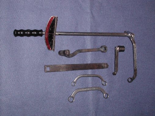

              The simplest tooling is to find a common
              cheapo imported torsion wrench (plenty accurate enough!) that has it's 1/2"square drives pointing both up and down. (Critical for retorques in the chassis.)
              Then get a common "obstruction" wrench, the "C"-shaped variety, that has 5/8" on one end, and 9/16" on the other.
              The third component is a 5/8" allen socket.
              The 9/16" end will fit on most 1/2" square drives giving you two ways to use it to get onto hard to reach base nuts. The other drive on the torsion wrench gives you two more. This means four different arrangement possibilities to get at them.
              The 5/8" allen socket allows the obstruction wrench to be reversed to attack the headbolts.
              Attached is a photo of many various adapters (mostly for Chiefs), but the top is the arrangement I have described.
              Don't even consider a silly "clicker" torquewrench. Bury it instead in the back yard somewhere.
