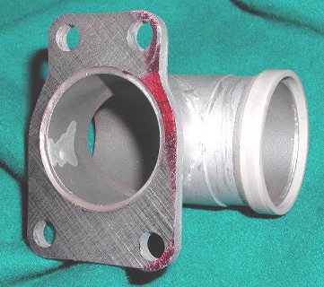

      Note that your original steel manifold ('48 -'49 only) has some unique peculiarities. In the attachment you can see a dimple within the bore (painted with a sealer). There are three of these stake marks that were part of the assembly procedure before silver-soldering. All too often these leak air.
      Another peculiarity is the malleability of the flange. Note the partial grinding shown in the attachment left ink in an area that corresponds to the idle bleed gallery on the carburetor. Fastener stress commonly bends the ears of both carb and manifold flanges, particularly with phenolic blocks between, but the steel manifolds are so soft that they even produce a mirror image of the carb's distortion!
      Because of the soft nature of the metal, the spigots distort and wear from brass ferrules of course. Shown is a replacement cut to fit from PEEK that requires only a fraction of the torque upon the nut to seal, yet still provides the tensile strength at high temps to support and secure the assembly.
      Many around the world are turning to this material for this and other applications. Although I offer the reconditioning service, I will gladly post photos of my tooling to anyone who wishes to do the same.

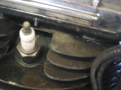

          Also, 48 pans should not have d-rings. this one does and one is cracked.
          also, thie pic shows a defect on the head where the pan screw went thru. should I just not worry about it. this is the only pans screw that is broken on the head

          Joe
            Berny!
            When brass was all there was for a seal, a compression gland-nut assembly (plumber's style) was the most secure manifold possible. But... brass is un-forgiving in many ways.
            When suitable synthetic rubbers were invented, HD realized they could reduce production costs dramatically by eliminating nipples, rivets, ferrules and nuts with just some gummyworms and clamps. This proved a very serviceable design.
            But now digestive fuels eat gummyworms in just a season or two, making them another 'lit fuse'. And the PEEK alternative has eliminated the difficulties of the brass, making it now the superior design.
            The bottom line is that an o-ring conversion is an un-necessary and expensive way to depreciate a vintage machine.
            PS: Reinforcing ring screw holes are easily helicoiled, and I'm certain that HeadHog can achieve any necessary cosmetic repairs as well!

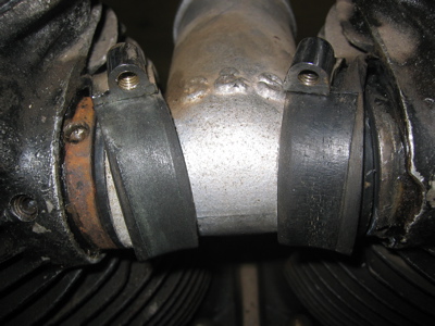

                  Well, Who is going to Oley, Penn rally this weekend
                  I am trying to get the headds off before then
                  I needd to know whats next, I thought the mainfold would come out here, but it looks like the heads have to come off together as a unit. I can slide the S & S manifold up and down, but i do not see it comming out.
                  when i do, then from what you telling me, we should know if the insert nipples are still threaded or what.
                  Joe
                  Ps The manifold rubber bands wont nove anymore, do I need to cut them
                  also, there is aplastice o-ring between the manifold and inlet. and at the inlet of the head, there appears to be an extension sticking out from the head that does not let me just slide it out. not that i have ever done this before.
                    Berny!
                    Why won't the clamps come off the manifold? Cutting the o-rings is normal for convenience, but with clamps removed the manifold should fall out. They appear to be silly two-piecers, enough to cause problems all by themselves.
                    Are those both latemodel bands AND o-rings? Gawd.
                    You have Colony adapters threaded into your head castings. Pressuretesting those will help you decide if you need/want to replace them.
                    You certainly would at least want to go back to OEM style clamps and just o-rings, even if the nipples are sound.
