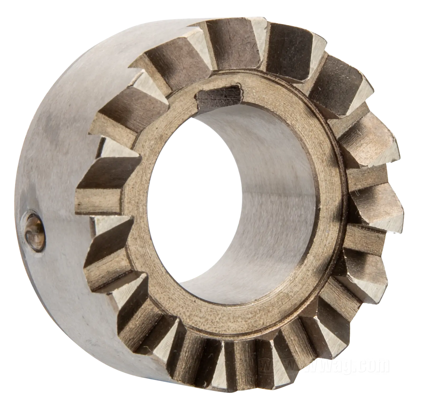

    Hi Guys
    Unbelievably I seem to have lost this part, so I need a replacement. The parts book states 33381-39, but the ones I've seen for sale are the later ones with a single keyway and my shaft has two key ways, and two keys are in the parts box, so the original gear must have had two keys.
    Will the new part be ok with just the single key?
    Enclosed is a photo of the original, and following is a link to the new part.
    Steel kick starter clutch for 4-speed Big Twin, replaces Harley part HD 33381-39, weight: 90 g.
    Thanks

    Originals use two keys, reproductions use one key, both work fine (originals are tougher).
