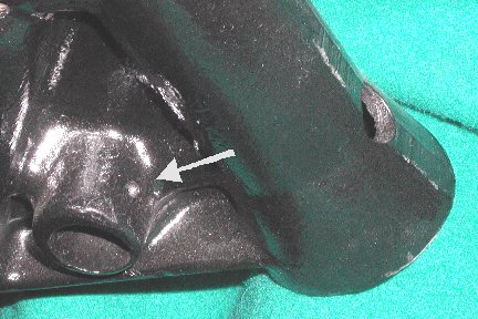

    There is a small pin that goes in from the top around the 1 or 2 o'clock position of the casting. If you clean the paint off you should see it. You'll need to drill it out (it goes right into the outer edge of the lock assembly) and then wiggle the lock assembly out. Given that NOS neck locks for your 56 sell for $50 on eBay, I'd probably let the cleaner's destroy it and then pick out what's left afterwords and put in a new one ... Perry

            Attached is a pic of the pinhole location.
            It is best to use a left-hand drill bit. I wiggle an old key within the core while drilling to feel when it loosens, lest the drill damage the core.
            The hole can be tapped for a set screw for future maintenance, and covered by filling with paint. But if you are really a fanatic, I believe the originals were possibly screws that were chisled off, untill rollpins were introduced sometime in the mid-60's.

              First I,d like to thank everyone for your response. This is by far the best $30 bucks I've spent . I belong to AMA,which I think is a great club,also H.O.G. just for the patch & pin. My hat is off to each & everyone of you, for your knowledge & willingness to share it. This is my first attempt at restoration ,and I'd want to do it right the first time . I am not going to strip my frame , I'll have it glass beaded. My neck lock works just fine, and don't want to screw it up. I did locate the pin, it's a 1/2 back and about 3/16 in dia. at 1:00 . INLINE4NUT what would you sell the nos lock for ?I might need it for a 54 frame. FLTHEAD how do I get in touch with Bill's Cycle in Pa ? Thanks D. N.

                              I was able to remove by first punching with pin and then drilling 3/4 percent of core out of screw to 3/4 of it's depth, then driving in an old worn out small philips screw driver #1 maybe. Gave frame some heat with propane torch and out it came.
