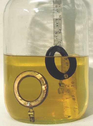

            Brass floats must be set very deep to achieve the same fuel level. Cheap english-brass floats made in India should be leaktested in hot water before setting at ~3/8", as they weigh three times as much as original corks and Armstrong floats. American-made Kokesh floats do not leak, but they weigh four times as much as originals, and must be set nearly out of travel at ~7/16".
            They will service, but gas mileage will suffer from the sluggish mass, pivot pin and floatlever fingers will wear, and performance will suffer from the loss of bowl reserve capacity from the gross submerged volume (see attachment.)

            Durable floats for Linkerts and Scheblers (on top in the attachment) are machined from an absolutely solvent-proof closed-cell foam. It even resists methylene chloride paint stripper, and drilling holes in it cannot make it leak or log.
