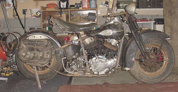

    I've recently aquired what I believe is a 1942 EL61. I'm very excited about restoring it. I'm going to do most of the work myself and I'm hoping I can get a little help from you more experienced folks out there... This is my first post since I've joined, so thanks for putting up with any of my ignorance.
    Can anyone tell me some good books of reference or decent parts books? I'd like to stay away from over the ocean stuff if possible. How about some hints on starters?
    I've been restoring and rebuilding cars and trucks for a while but this is my first bike, so I know a little of what I'm doing. I realize a little info can be a dangerous thing. I'll listen to some wisdom if there's some out there to share.
    I'd like to restore this bike to original condition.
    Thanks for help in advance.
    Gary
    PS I've got a pic to share, it's not much but I've got my Harley!!!

    Nice looking project. I'm, jealous. My latest restoration was a 46 FL. I have two books that I would recommend. First, you definitely need to purchase Bruce Palmer's, How to Restore Your Harley-Davidson. This can be found at local book stores here in Oklahoma for $29.95 (Barnes and Nobel or Borders). Or you can buy it from conansclassics.com. I am not sure about the book stores in Oregon. This is a must have book for 37 to 64 big twin restorers. It has a few inaccuracies but overall is a great reference book for the money. Also, a book called Classic Harley Big Twins by Greg Field and Tom Murphy is another detailed book that I found useful.
    A restoration parts company called Antique Cycle in Rockford Michigan has high resolution factory photos/lithographs of a 1940 and 41 knucklehead that they will sell you (616) 636-8200. They can also supply the correct color paint if you want it in lacquer or enamel.
    There are several books (mostly coffee table style) that show neat but incorrect bikes if you are a details type person. I would not recommend that you use these as a reference of what is correct and what isn't.
    Hope that helps. There are a lot of smart restoration folks on this site that would love to help you.

        You are a lucky boy!! Appears to be a fairly complete bike. Very nice. You should come out to the National Road Run in ORG. Meet some folks. See a few bikes on the road. July 24 - 27 Oregon Trail Chapter, John Day, ORG. Evenings around 6pm are a good time if you just want to make contact. Have you been out to a chapter meeting?
        I'm really impressed - that you were able to post a picture! This gives me hope.

            Admin Dude! Lucky? hmmm... lets just say I was at the right job when a person came in looking for a couple of dollars. My lovely wife and myself would love to be in John Day for the ride, but it seems we have a mountain top fire lookout reserved for that weekend. Bummer!

              Hang on to the Greg field Knucklehead book. Besides being an excellent reference book, it is a superb "coffee table" book containing factory (studio) black & white pix of the motor parts, and equally important it is out of print and copies are over a hundred bucks from amazon.
