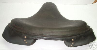

Perhaps there is somebody that knows... Following are some pictures of a '39 accessory catalog that shows a deluxe seat. The seat following it looks like that in the catalog, (part 3181-39) (I copied all photos from ebay). Neither the catalog or the seat look like what I thought a '39 seat should look like. Any thoughts? I am in the process of restoring my '39 knuck and the seat is coming up. Thanks.

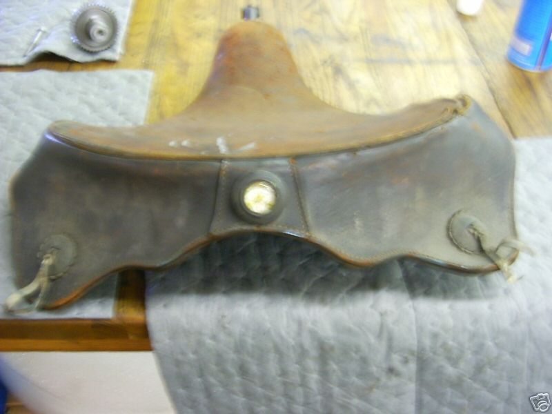

Here is the seat that appears to match the brochure, and the guy that was selling it said that it was a '39...Attached Files

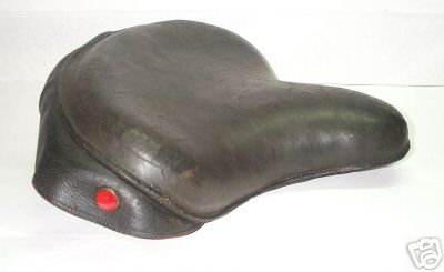

Now, here is a photo of what I thought a '39 seat should look like. This is also similar to what Palmer's book calls '39.Attached Files
The seat that is shown in the catalog and the one on eBay you have pictured is indeed a 1941--42 seat. The one with the crystal floral ornament is a 1939. The catalog calls it a deluxe regular solo as it was a thin pad seat with a skirt and non-vented shell assembly. This was the seat called Rhino russet. The eBay seller was confused to say the least.--Michael
This ebay seller was not confused- to say the least. Palmer's book is indeed a great reference tool. However, I would be remiss to have doubts and not consult my archives of Factory original catalogs and advertisements. I had hoped by scanning my fragile book I would avoid and confusion from people who don't have the same access I do. The picture of the tan seat with the jewel in the back is a '39 and a nice one. It has become the standard by which most people judge what is or isn't a '39 seat. As my Factory original catalog shows that isn't the only seat Harley sold for '39. I hope this ends the confusion.
The accessory catalog page that appears at the top of this post is from 1941. The seat shown with the rosette, concho, latigo strip, and crystal floral ornament is a 1939 seat. I have been researching seats and saddlebags for 8 years for a book I am writing, have all the accessory catalogs from the 19 teens through the 1960's, and have copies of the original production drawings so I believe I know what I am talking about!!!
I forgot to add that in 1940, the deluxe solo became a true deluxe model with 2 inch thick padding. It had a scolloped skirt with fringe. As it was a deluxe solo seat, the part # was still 3181-39. In 41, the padding remained the same but the skirt was changed to the style in the catalog page at the top of this post. As it was a deluxe solo seat, the part # was still 3181-39. In 1947 the part # for a deluxe solo changed to 3181-47.
