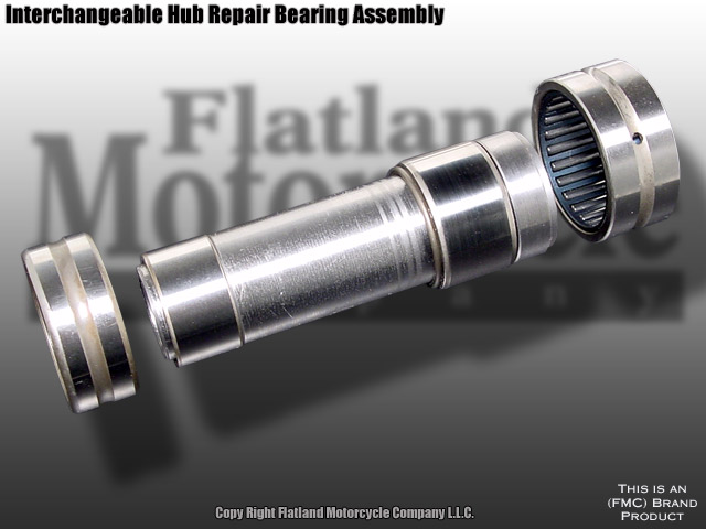

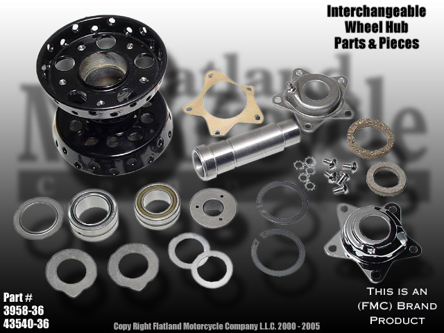

          If you have a machinist, here's our repair kit. These are the same parts we've been using in our replacement hubs for years. Contact me off the forum if you want more info.
          Kurt

              I like the idea of the long needle bearings, but how is the side thrust taken care of? With the stock wheel components? Does the hub need to be hard bored to fit the bearing?
              Thanks
              Mark Masa
              • KDR
                MMasa,
                Yes, the original components make up the rest of the install.
                And yes, the hub must be machined to accept the bearings. The bearing fit should be an interference fit only, not a tight press fit because it will destort the bearing race and cause problems later.

                  I bought a book about 25 years ago titled "Custom Chopper Cookbook" by a fellow whose name is Mike Geokan. In it he has some plans for repairing those nasty pitted star hubs in which he uses two sealed bearings per side straight from your local bearing supplier and some machine work. I did it to my hubs 20 years ago and they are just great.
                  As for side thrust there is very little on a motorcycle...(remember you are leaning when cornering, applied mechanics involved here)... unless of course you have a sidecar or a trike. My memory isn't all that great being a little longer in the tooth but I think the bearings I used were sealed ball bearings.
                  If you're interested in it give me a shout and I will e-mail you the info.

                      You're right Cotten, this is the smallest bearing the engineer's were comfortable with. There's still some machining to the hub, but enough that the hub is strong enough for normal use.
