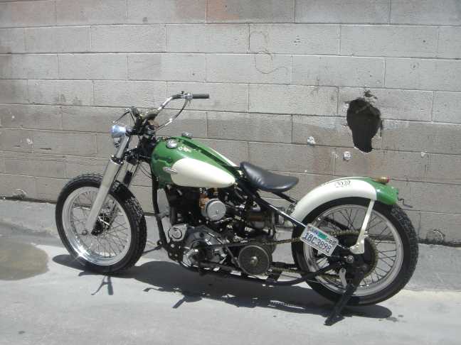

    I know he won't mention it, but I will. Chopper Dave's twin carb knuckle bobber is in the latest edition of "The Horse." Wow what a bike! Traditional bobber with a crazy dual carb set up. He gives some good tech info on building it using to front cylinders. The bike features many parts he made himself through Chopper Dave's Casting Co. If it sounds like he's my friend, he is. Check out the bike it should stir up some good tech discussions. I personally think he should have stroked it, but what do I know.
    Great - could you post some pictures of the head intake ports? pictures of the completed bike? Sounded like it was fun project with lots of headaches.
      Chopperdave did a helluva job with that knuck. There are definitely some features on that machine that show his craftsmanship capabilities....... I could be wrong, but maybe part of not stroking it had to do with keeping it period correct.......
      • Flathead Jedd
        I pretty sure Knuckles were being stroked using 80 ULH flywheels during this time period. I'm just razzing him. Maybe he'll post a reply as to why not. Maybe he was just scared. I'm posting one pic I have. The magazine article has better ones. Dave post some good pics of the engine.
        • Flathead Jedd
          The pics not coming up. Second try
            I sit corrected Jedd.....your right about the flathead flywheel swap........
            • Chopperdave
              thanx for the compliments on it
              well, if ihad had some stroker wheels i might have used em, but not told anybody... until someone saw the stroker plates...
              i actually wanted to use 61" wheels in it, but again i didnt have any, i have some now, but im not takin it apart
              ill post some pix of the bike tomorrow and pix of the motor...
              jedd, there is a huge hole in your cylinder head now....
              HUGE
