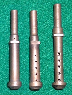

    Hi, i have a couple of M-35tps i am using on a knuckle of mine. i have two bombsights that i want to use. could somebody give me exact info on which main nozzles to use and possibly a pict so i can identify it when i see one and any tech tips on setting the bombsight up. thanks BJK

    Sorry for the delayed reply, and the sloppy scan attached.
    On the left and center should be a bombsite nozzle front and back. (This is an old reference, and my memory should be questioned!)
    The right is a common M74B, again if memory serves.
    But how are you going to retain the nozzle, when the bowlstem is bored all the way through? I believe bombsights had a shoulder drilled only for the spigot to protrude.
