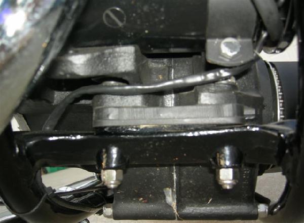

          I have a 38 EL motor in a panhead swingarm frame with the weld on hardtail.
          Two things I had to do.
          Notch the down tube to clear the rear exhaust tin. This eliminates the ability to use a pogo seat.
          Also needs a thick spacer on the front motor mount.
          I will try to send a couple of pics.
          • rousseau
            • rousseau
              pic of spacer

                Thanks!! I do have a pogo seat on it now but if I have notch it out I will just run a different seat. Good luck with your bike,sounds nice. Thanks for the answer and the pictures!! Ron
