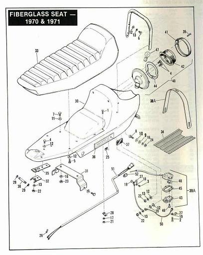

    I can e'mail you a copy of the Factory Parts Catalog breakdown for this seat along with the Part Numbers/Description from my Sportster Parts catalogs.
    I believe the same seat was used on both the Big Twin and Sportster lines for the years 1970 and 1971.

        Here's a breakdown of the seat from the Sportster catalog that shows the rear light. maybe it'll help
          Here's the Part Numbers.
          Does list everything as XL parts, but possible some of the same parts carry over to the Big Twin.

                        Checked a big twin parts book last night. The only parts that are common to the XL and FX seat are the tail light and license plate light. The FX uses FLH fender struts for the boat tail seat. Hope this helps.
