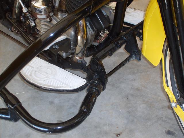

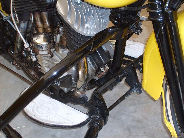

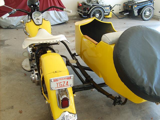

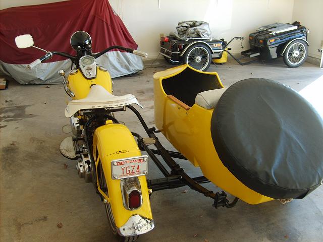

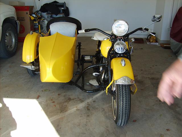

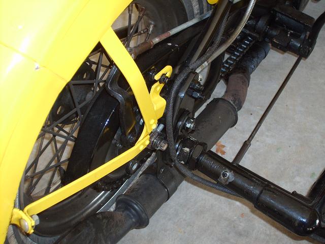

          With a little simple fabrication an LE sidehack can be hooked to a WL. The 45 will not handle the LE sidecar with the ease an FL will but if you don't expect to run highway speeds for extended periods it will do the job. At speeds under 30 mph the little WL will probably shake her head so you'll have to screw the damper down for around town running. I've had a lot of fun playing with mine. Attached are some pictures of the bike and sidehack brackets( if I can do this right ).
            So forget the pictures. This forum thing keeps telling me the file is to big. I could e-mail them directly to you if you are interested.
              Maybe this time.
                Looks like I'll have to post one pic at a time.
                  Again.
                    Jack
                    Question about the sidecar in the pic, is the sidecar body steel?
                    looks to be clean of any rivets in the body also what modifications were done to mate it to the 45.
                    I assume something to the mounting hardware?

                      Brackets.

                        Front mounts.
                        • #13
                          More front mounts.
                          • #14
                            The sidecar box is steel. Really nicely done. Looks factory. I've been told it is a "speedster"" body but I don't know sidecars very well. I bought the chasis without any sheet metal. The fender was in my grandfather's shop forever, so I had that. Bought the box from an area farmer who was retiring and moving to town. He had had it in his barn for as long as he could remember but he could not remember what it came off of.
                            • #15
                              Jack, I can assure you the guy I got my LE from didn't do anything even close to the job you did. Very nice work. It looks well thought out and clean. . . . . And safe.
