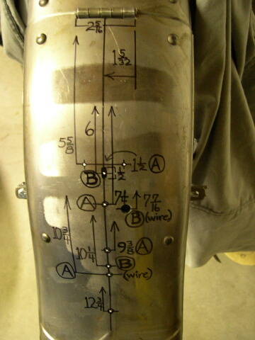

            • dommi7
              Here's a pic from my files - I don't know where I ripped it from and can't vouch for accuracy.
              • dommi7
                And one more:
