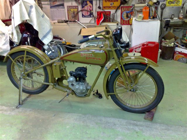

        :-) That is my 1932 hybrid! The motor, frame and tranny are 1932 as well as a bunch of other small stuff, but the frontend is pre-1930 as is the dash.
        • Fiskis
          In my opinion the "hybrid" bike is - compared to most "restored" Singles I seen - very close to a genuine 1926/27 B Single with a 30.50 motor. The 1932-34 Singles had a specific frame with shorter and fatter VL/RL type gastanks.
          The cast sprocket cover on the right side of the transmission has the slotted screws that were used only 1926 as well as the rigid kickstarter with no bicycle pedal. Also horn brackets are 26/27 type as front hub etc.
          Ecxcept the larger cylinder the only wisible major "hybrid" part is the 1931-32 primary cover.

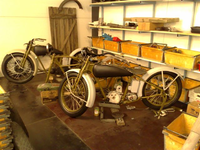

                Good, picture posting succeeded! Up front is a 1926B, second a 1928B and third a 1930 BAF. I'll search for some pics of the 500cc:s (30.50 cu.in).
                Fiskis
                • Fiskis
                  The fourth 21 cu.in. Single is this to be 1927 B. It is built of all the discarded pieces from the other three. The owner takes pride in repairing impossible parts or fabricating the missing ones. As you can see he is ahead of us others, although we use the best selection of parts found. His work is only slowed down because it is hard to find parts broken enough!
