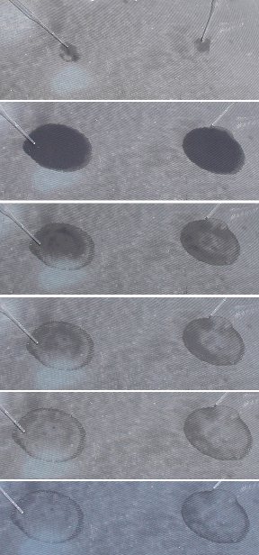

                  I then poured the 100ml samples into tared watch glasses (pyrex casserole lids, actually) and evaporated them upon a slab of pooltable slate in the sunshine, with a surface temperature averaging 130 F.
                  The P4 "tracked" on the dish like wine on the side of a glass, and 'bloomed' its surface with convection.
                  The gasoline kept a mirror reflection upon it.
                  By three and one-half hours time, both had reduced to an oily residue, however the P4 was remarkably thicker and darker.
                  Both stunk like varnish.
                  Continued baking for another ninety minutes reduced the weight of the residues only a few tenths of a gram: A final total of .75g for the P4, and .90g for the straight gasoline.
                  The difference barely exceeds the accuracy of the triple-beam scale.
                  So about one percent of either fuel doesn't vaporize at 130F.
                  The P4 also displayed more debris, and a noteable skift of white precipitate settling out.
                  If the stuff doesn't vaporize, what the hell is it, and why is it in our fuel?
                  A comparison of drops 'flash' evaporating directly upon the slate is attached, petrol on the left, P4 on the right. Photos were taken roughly every ten seconds.
                  I could not detect a difference.

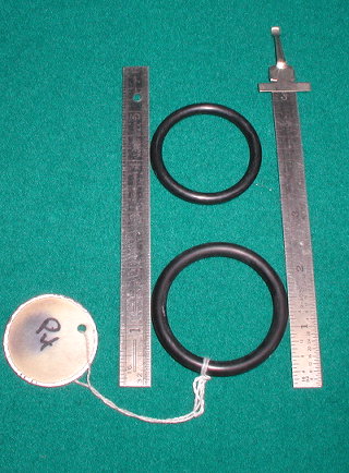

                        I realize there are few O-rings on Flattys, however the fuel's effect upon V-TWIN OHV manifold o-rings in either fuel produced dramatic swelling within 24 hours (see attachment)
                        Similar immersion tests concluded that Liberty's signature cosmetic coatings, sealer, and float material are still impervious to the digestive action of a noteably agressive ethanol-blend.
